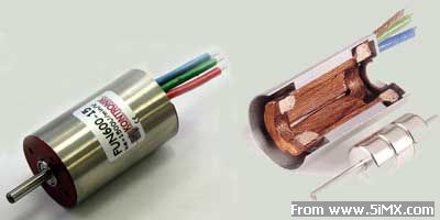

我的电机是kontronik的fun400-23无刷电机尺寸为28mm*40mm,kv值2300,电流25A结构如剖面图:(借用)

我的电机是kontronik的fun400-23无刷电机尺寸为28mm*40mm,kv值2300,电流25A结构如剖面图:(借用)应该怎么改呢

哦,这个可以不用改的。和我的差不多,只有轴上面的磁刚不一 样。我没有用过这种电机不知道效果怎么样,应该还可以吧。

但是,电流和转速能达到要求吗?我的电机是kontronik的fun400-23不是同厂的fun600-15(上图)而尺寸,电流都比600-15小,其实还有一个问题就是电机怎去改,绕线是不是要专用工具,线怎么绕?

MJR?:)haha.记得!.fun400-23应该不用改,fun400-30 IS BETTER!ECO MOTOR "KV"=2800--3200.SORRY MY LENOVO has some problems .i can not type chinese.so i'll wirte it in english.some europe racers suggested that the best KV for a eco-exp boat is between 2800 &3200.the prop is about 30mm,1.2p.if you use  3300MAH battery-pack it can gives you a running time above 6 minutes.so the KV of FUN400-23 is a little bit low for a eco.but you can try a bigger prop(32-33MM) on it,DON'T USE props THAT are TOO BIG for fun400-23(NEVER OVERLOAD YOUR MOTOR!!!) :em19: PS:about tuning motors,remember tuning is not a work that every one can do,ZHOUSHENG2004 is a pro in ECO class.he has some skills you may not have.so i suggest you do not tuning your motor by yourself.best wishes!!
自己做个模具就可以绕线了,我们这里就是这样做的。
